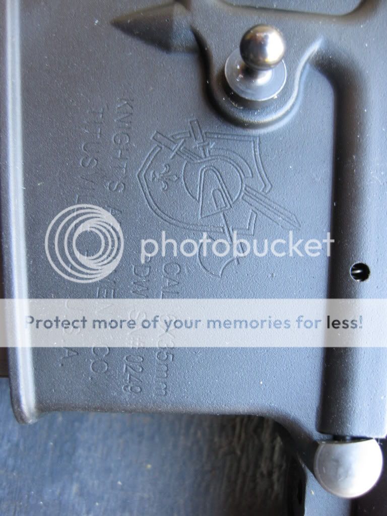

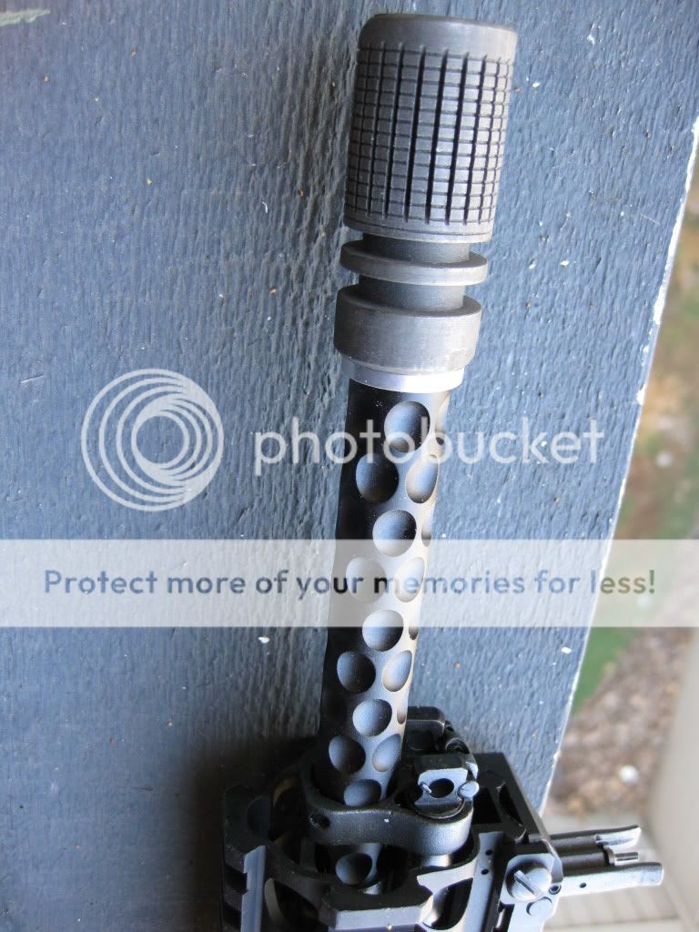

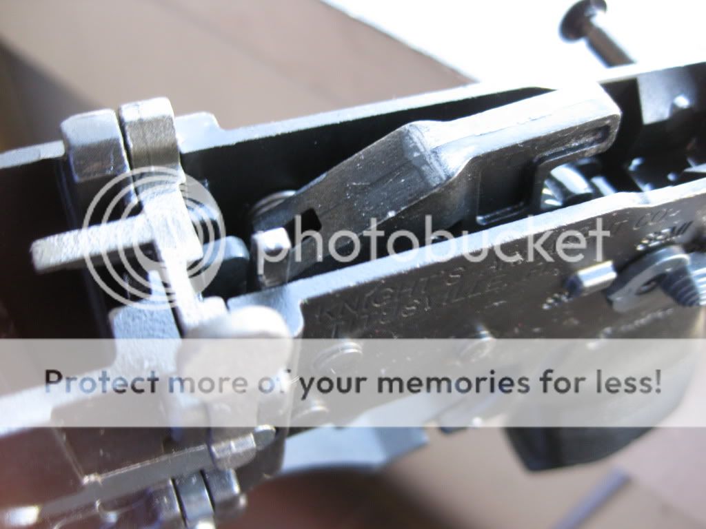

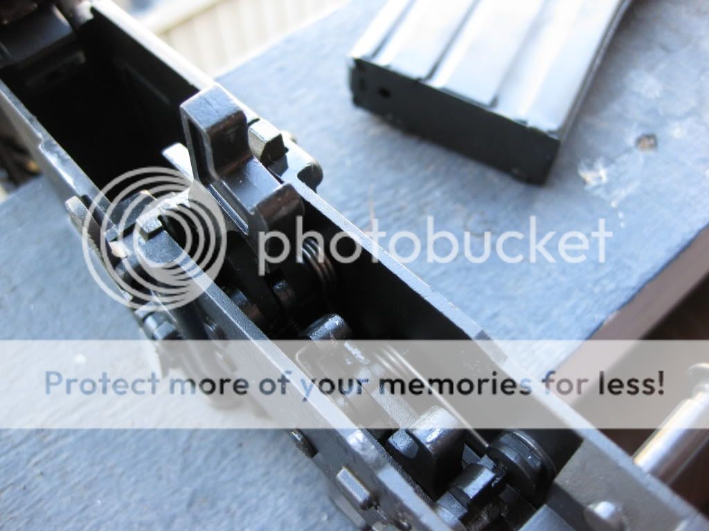

ecco qua l'ultima news che ho ricevuto....

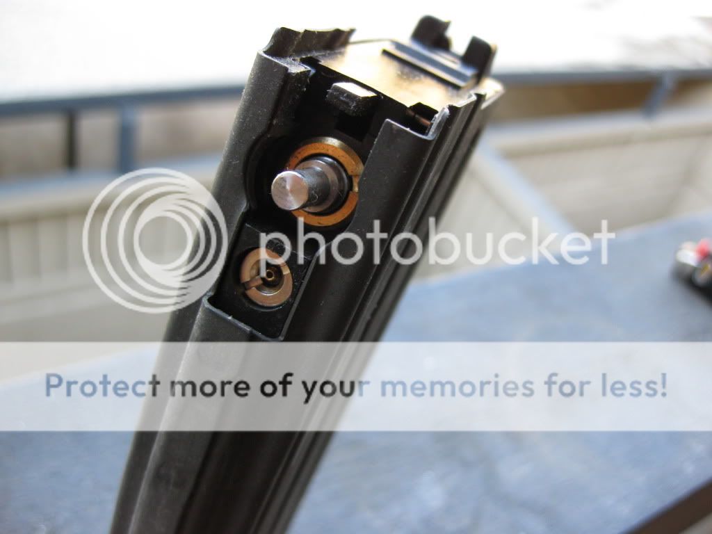

il gruppo scatto del 3za gen.....è..... stampato..... quindi in zama... arricchita forse con un poco di ferro arrugginito... dicono che cmq sia robusto
https://i78.photobucket.com/albums/j...p/IMG_3870.jpg
https://i78.photobucket.com/albums/j...p/IMG_3865.jpg

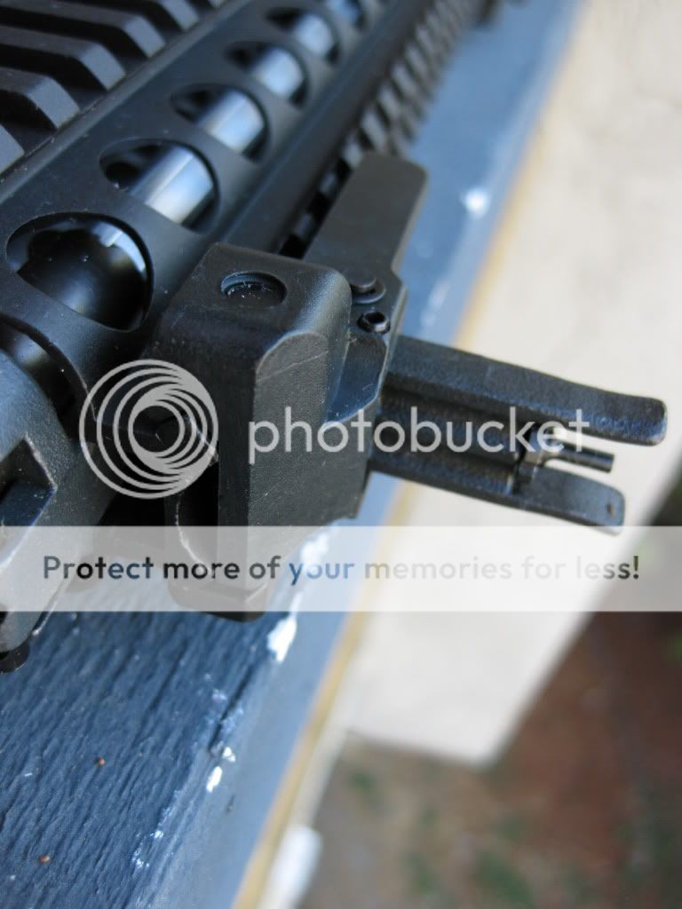

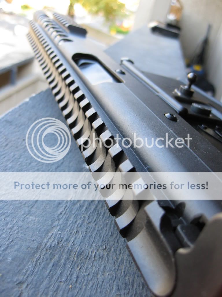

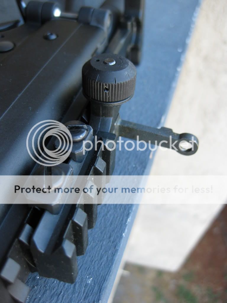

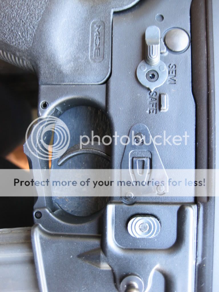

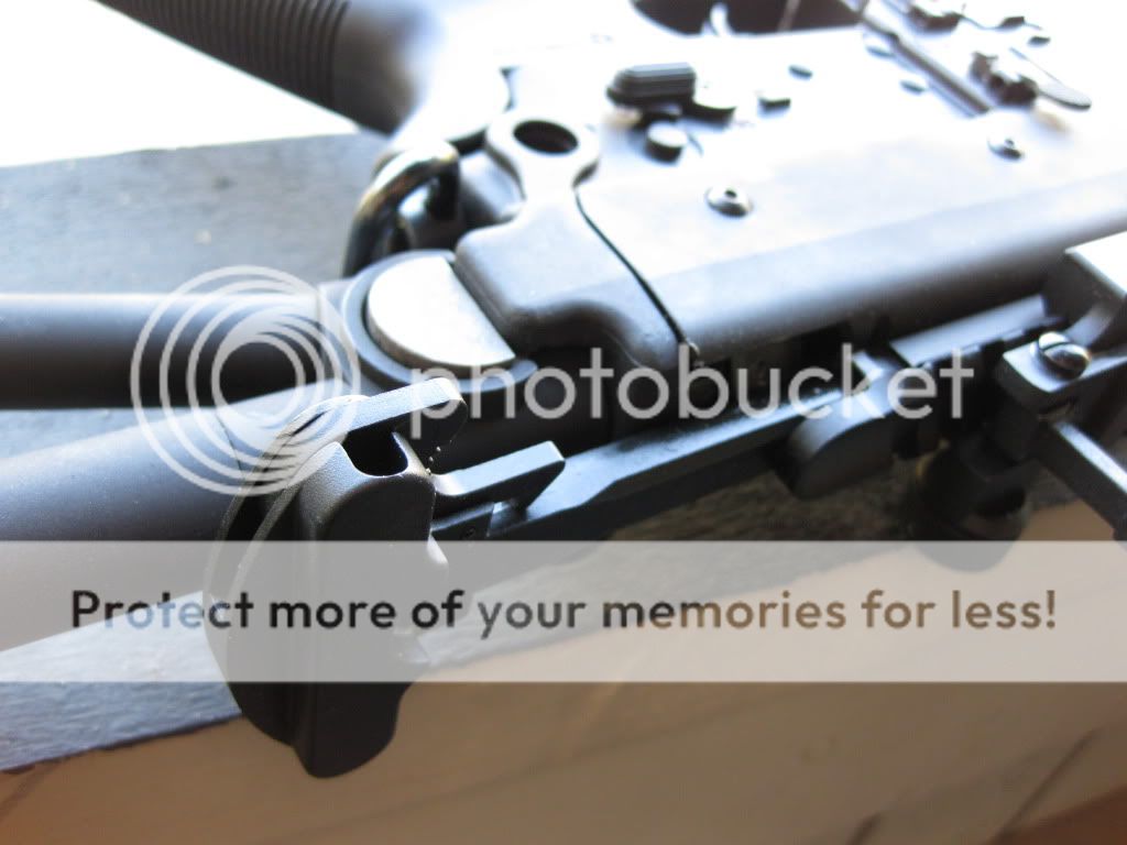

altre foto
https://i78.photobucket.com/albums/j...p/IMG_3756.jpg
https://i78.photobucket.com/albums/j...p/IMG_3755.jpg
https://i78.photobucket.com/albums/j...p/IMG_3751.jpg
https://i78.photobucket.com/albums/j...p/IMG_3750.jpg
https://i78.photobucket.com/albums/j...p/IMG_3747.jpg
https://i78.photobucket.com/albums/j...p/IMG_3744.jpg
https://i78.photobucket.com/albums/j...p/IMG_3743.jpg
https://i78.photobucket.com/albums/j...p/IMG_3759.jpg
https://i78.photobucket.com/albums/j...p/IMG_3764.jpg
https://i78.photobucket.com/albums/j...p/IMG_3762.jpg
https://i78.photobucket.com/albums/j...p/IMG_3760.jpg
